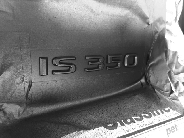

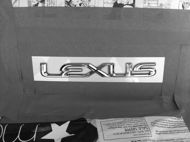

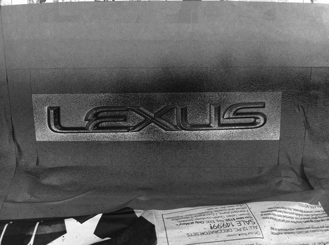

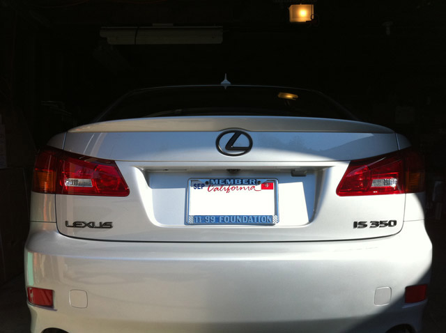

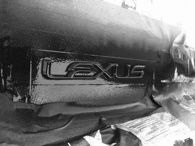

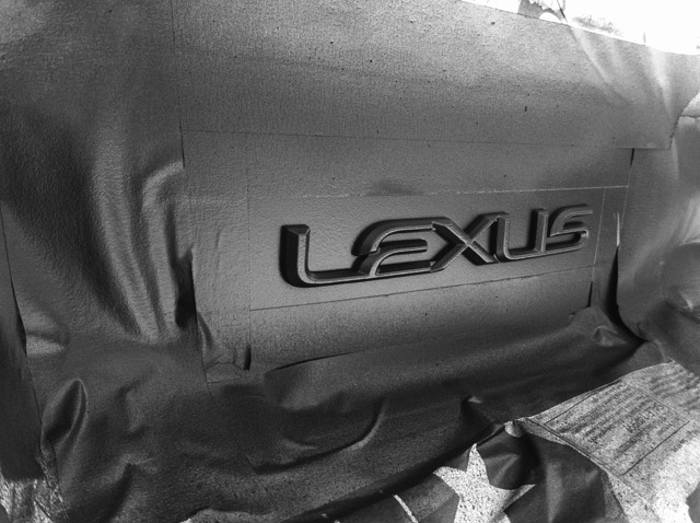

[QUOTE=mikemoto81;5824238]Did my rear emblems, front emblem, and the grille surround.....super stoked on how it turned out. I sprayed 5 coats on each.....check out my pics :D :
PREP WORK
FINISHED BACK EMBLEMS
LEXUS EMBLEM
"L" EMBLEM
IS350 EMBLEM
FINISHED FRONT (with a touch of editing lol...)
GRILLE CLOSE-UP
"L" CLOSE-UP
LASTLY....(if you plan on not removing the grille) Make sure you take the painter's tape off carefully, or else the Pastidip will tear off the chrome (as seen below). I used an exacto knife to help, but I still wasn't careful enough. Mine wasn't that bad tho...
ALSO....It helps a WHOLE lot peeling the excess Plastidip off with more coats, it doesnt rip as easy.[/QUOTE]
