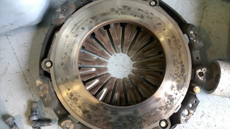

and the real world results were this
the 14lb fltwheel is still lightweight
and does not store enough energy to do a pure flywheel launch
so clutch slipping is still very necessary
as a result the clutch and flywheel ended like this after 3/4 of a season's runs
and thats with the upgraded cf disk and stage 3 pressure plate
[replaced with stage 4 clutch and drag only 6 puck clutch plate]
did survive several high hp nitrous shots
at least it got me home
