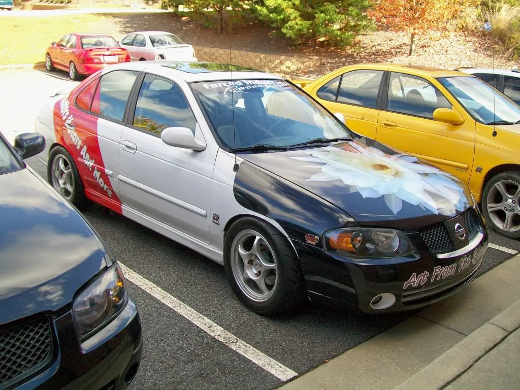

where it is now
there are some real stars here
lets start with those

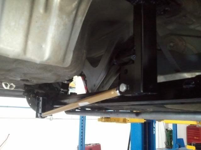

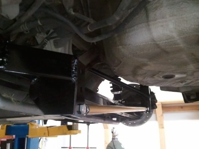

the biggest surprise was the panhard bar
i had the BCs, twin nismos, chassis supports
bent rear bar, etc
what did i need this for? esp for street
omg transformed the car
from frisky to indomitable

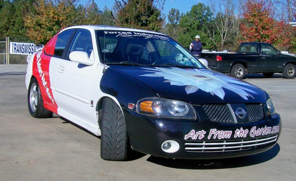

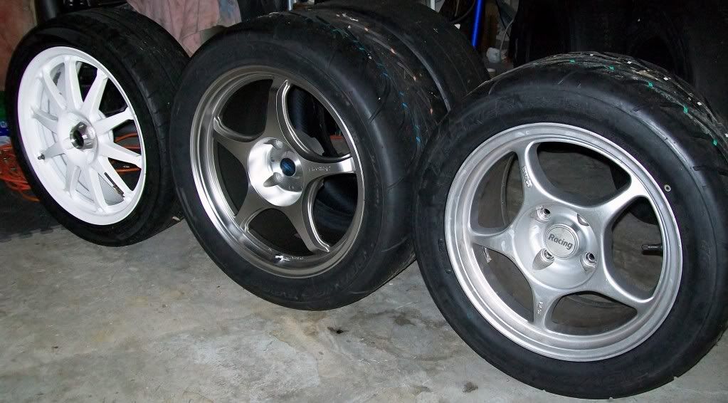

toyo r888s
just unbelievable stick and tough as nails, light too

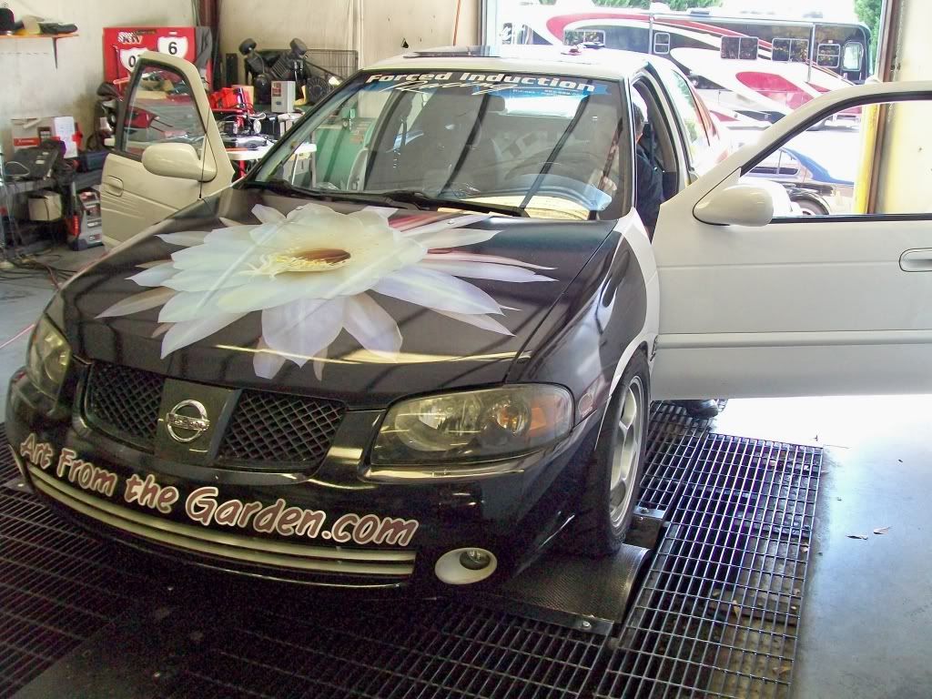

180hp, 180ft lb torque
dyno runs still seem top secret as far as charts go
but i was there i saw it
torque everywhere

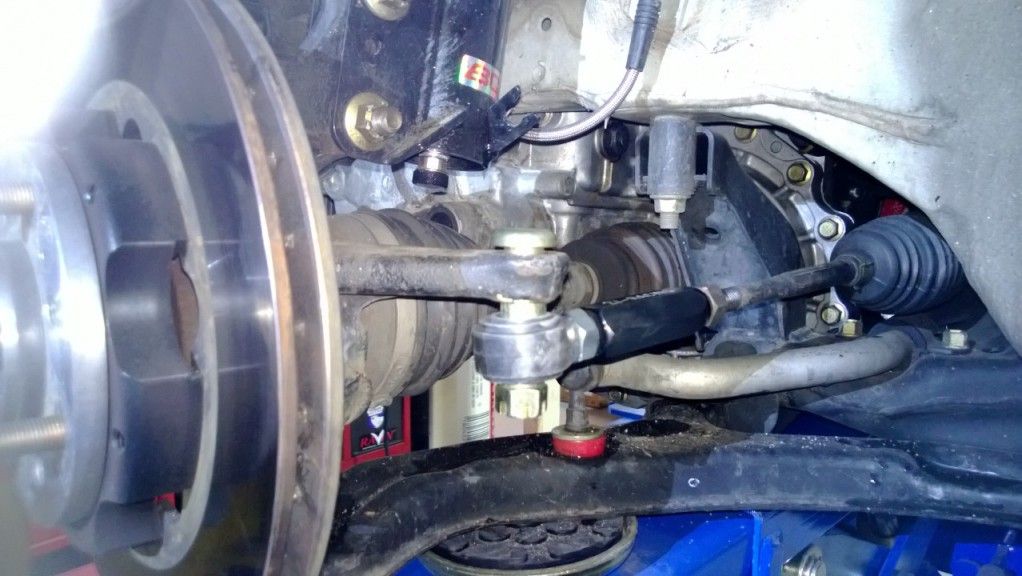

new parts, bump steer kit from 2j

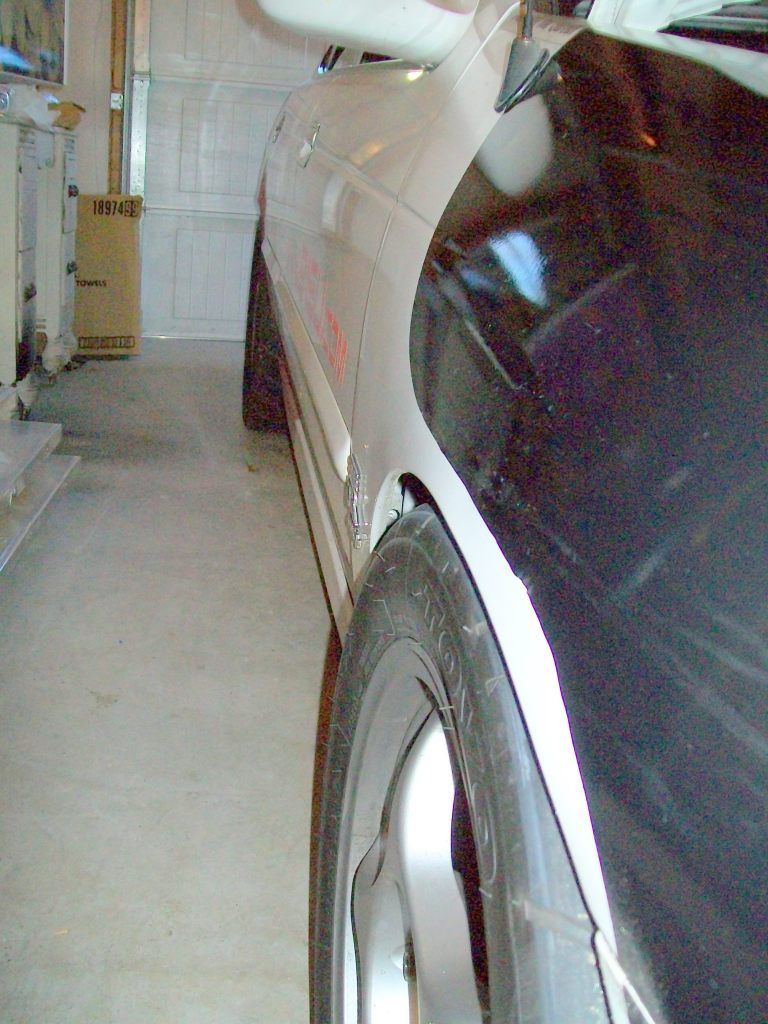

with 2* neg camber front and back

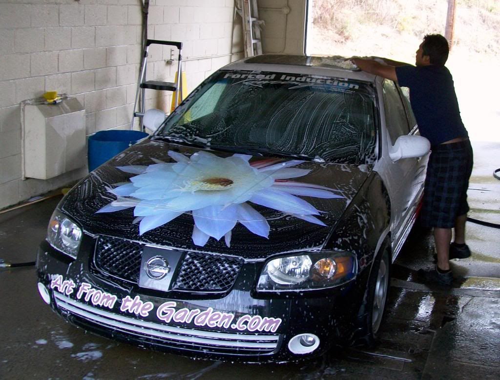

and in the wash

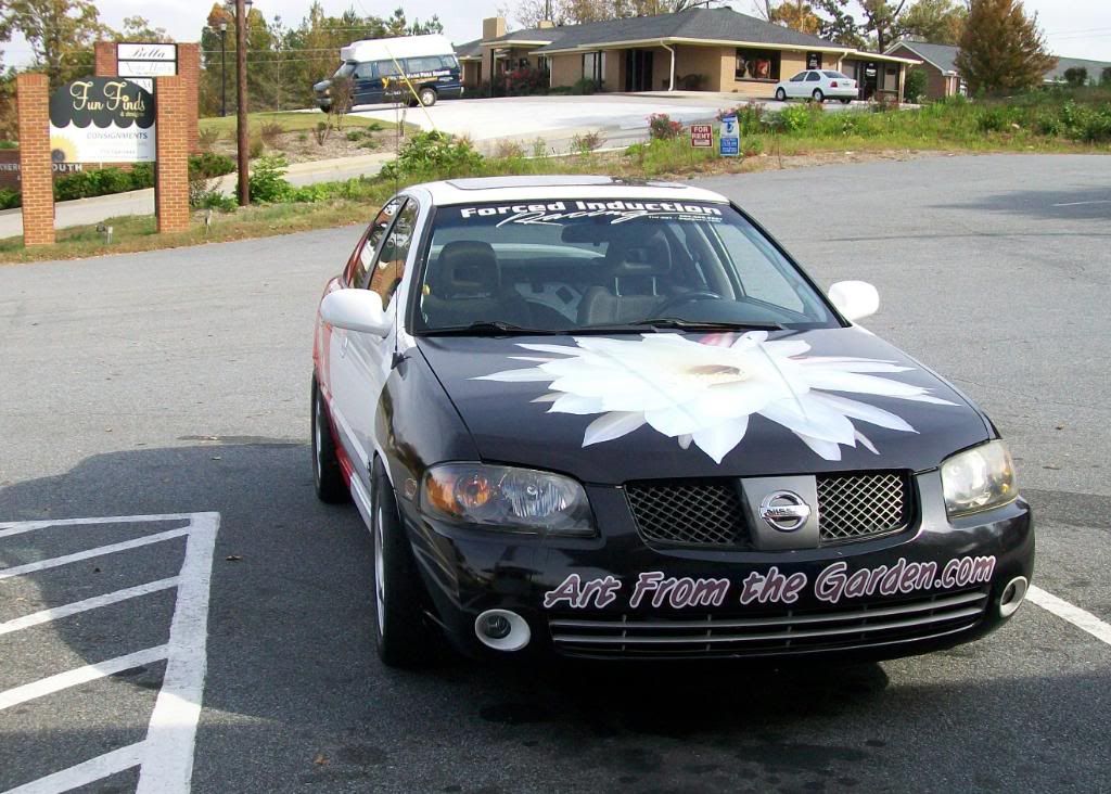

at the malt store
attracting marks for evermore

duesMANdella wrote:Yogi have you used those tires?
Im also adding this to your profile
and i also want to see more :)
i have about 6000 miles on them they are 1/2 gone
but are the best tires i have had on the car
kinda slicks for the street [but they work in the rain when newish]
