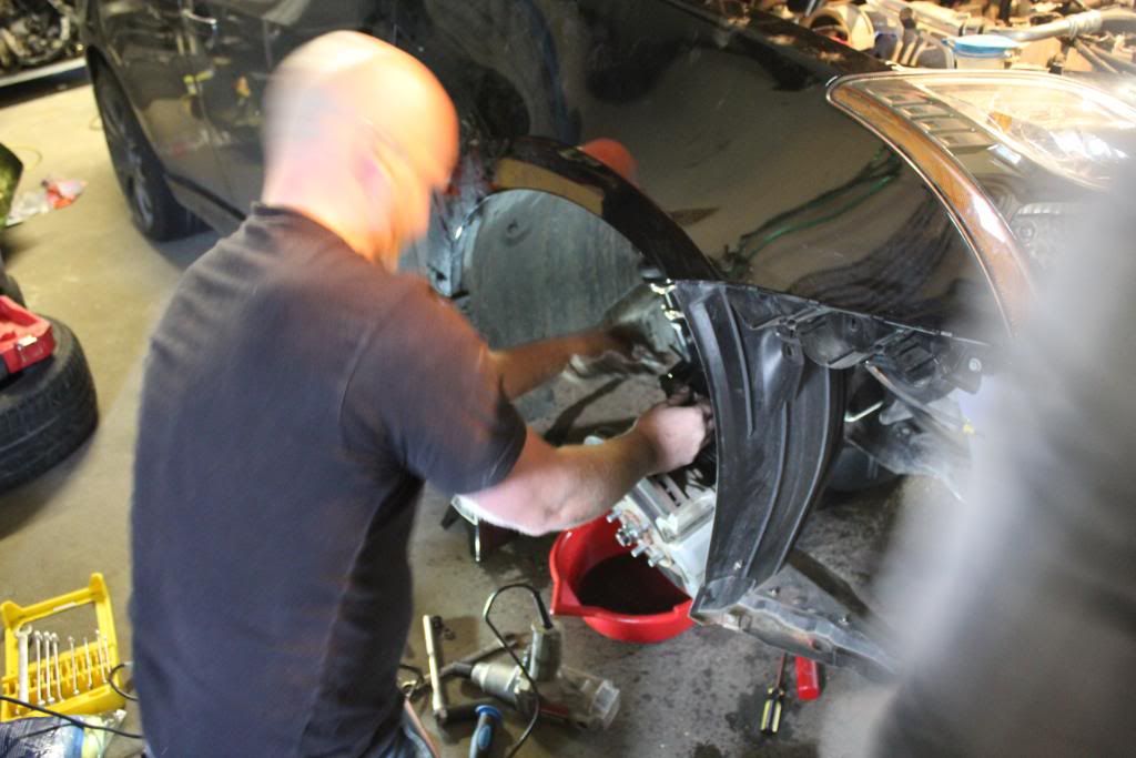

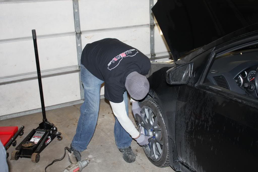

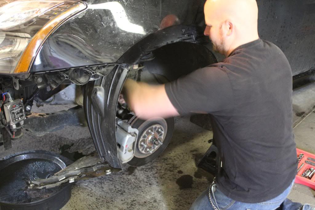

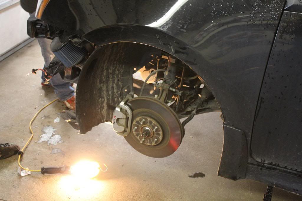

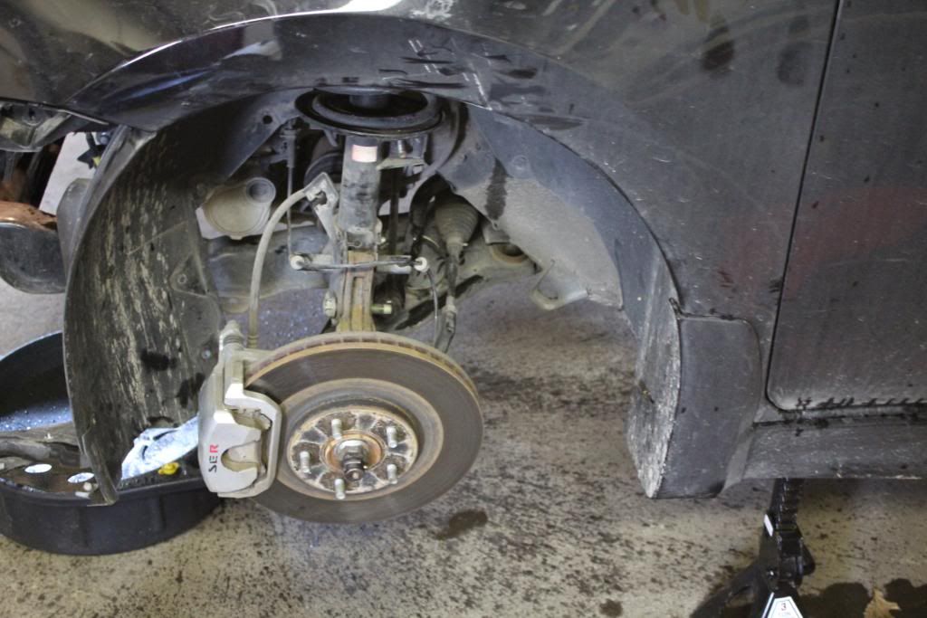

Update1: Pictures from the Turbo Install At Jesses. (http://s1176.photobucket.com/albums/x324/axelrtgs/Car/Turbo%20Install%20at%20Jesses/)
